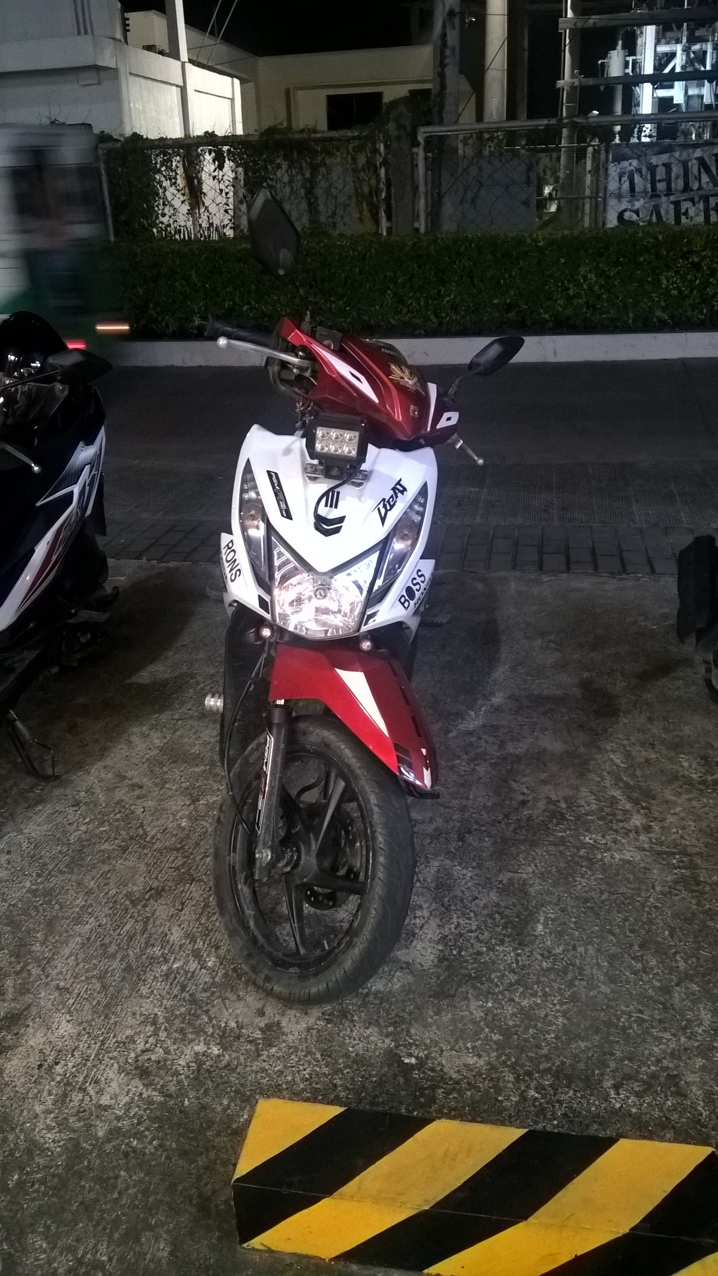

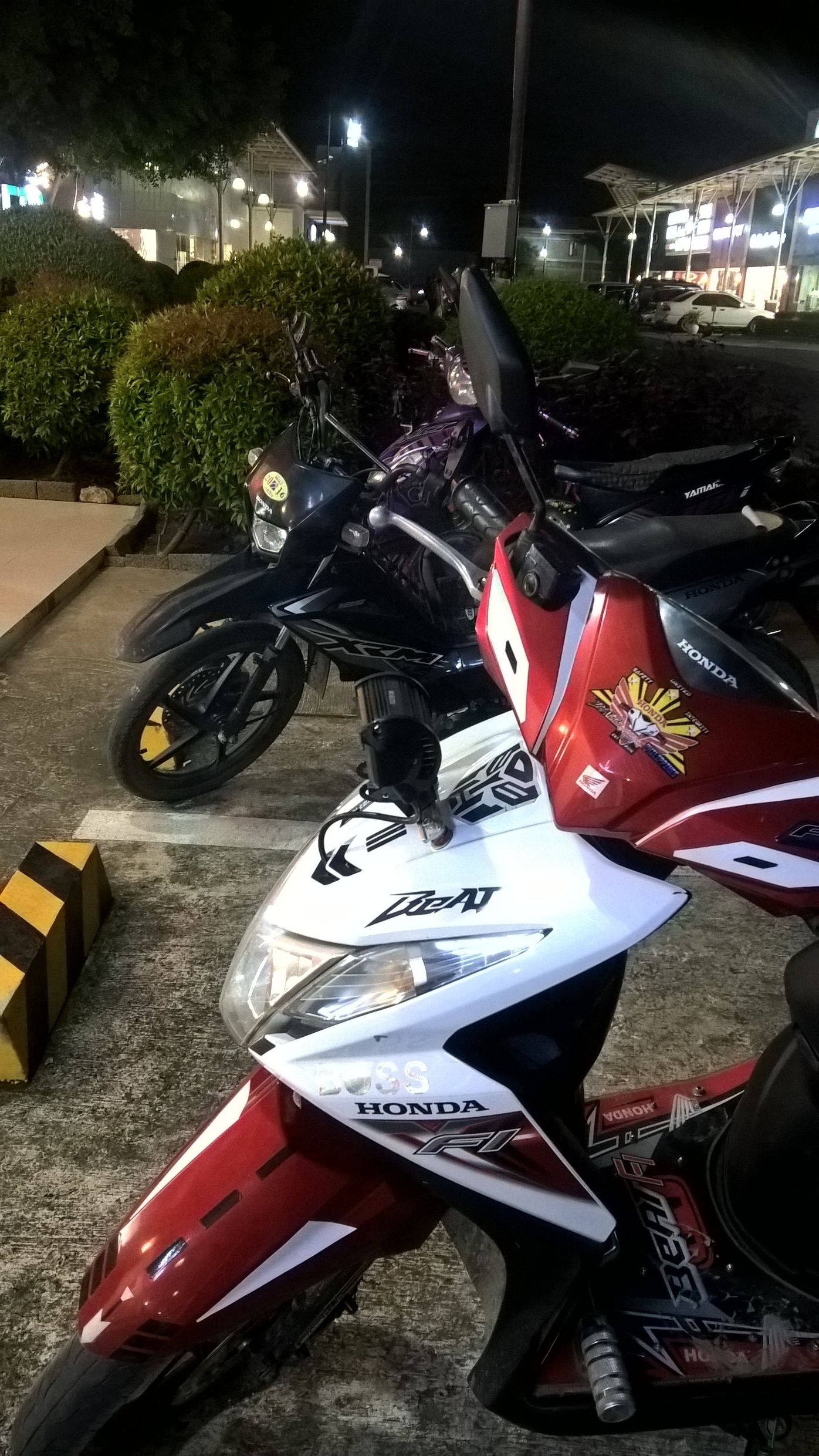

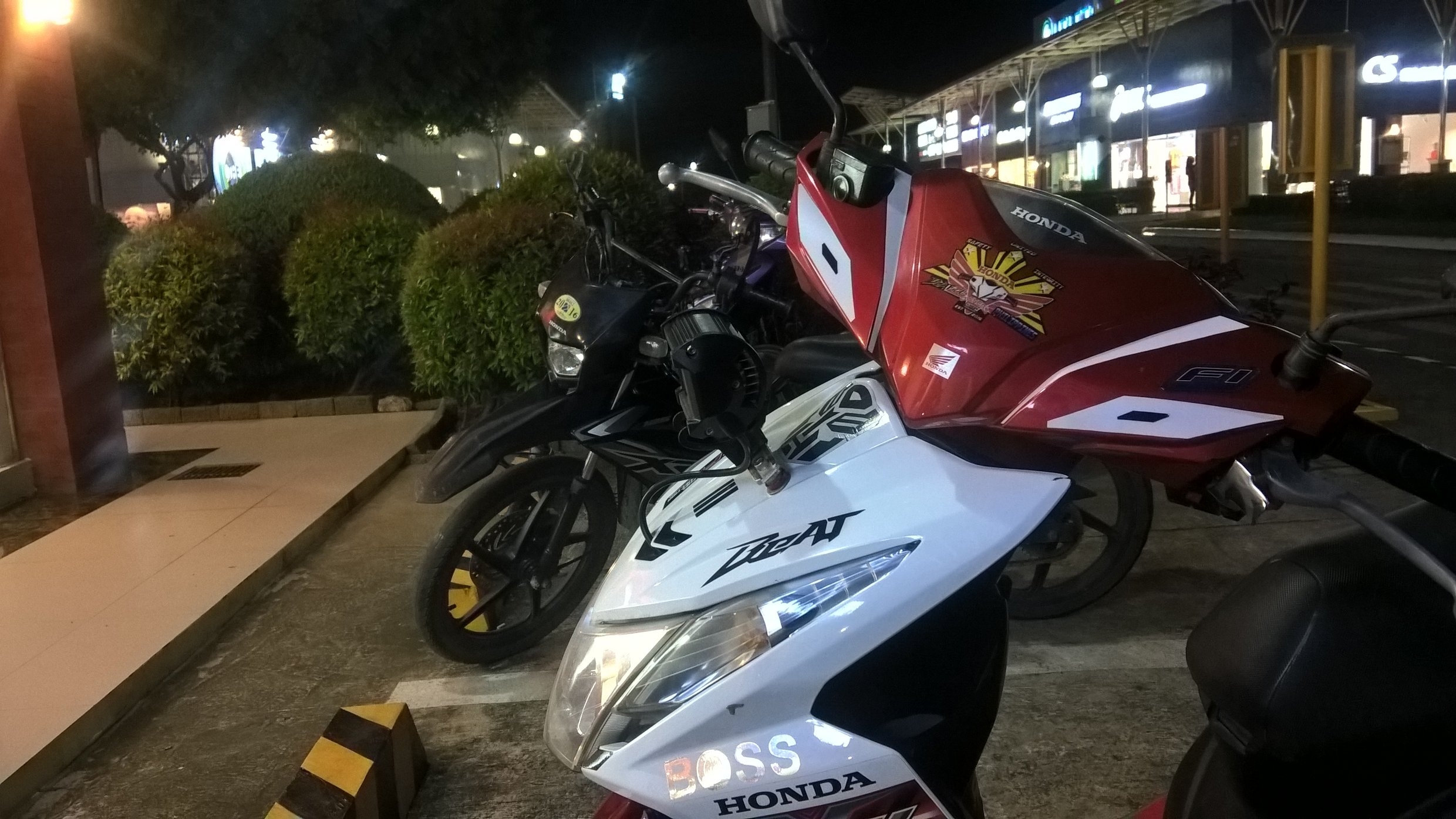

yup, have a look on the following pics. But that depends on the rules and regulation in your country. Or better, how strict they enforce them.
The pics showing a Scooter and not a undebone like yours. But doesn't matter, your have 3 Screews on the front cover as well and you can easily mount there a bracket for auxiliary lamps.
Such solutions are quite comon here for them who like to see something in the dark.

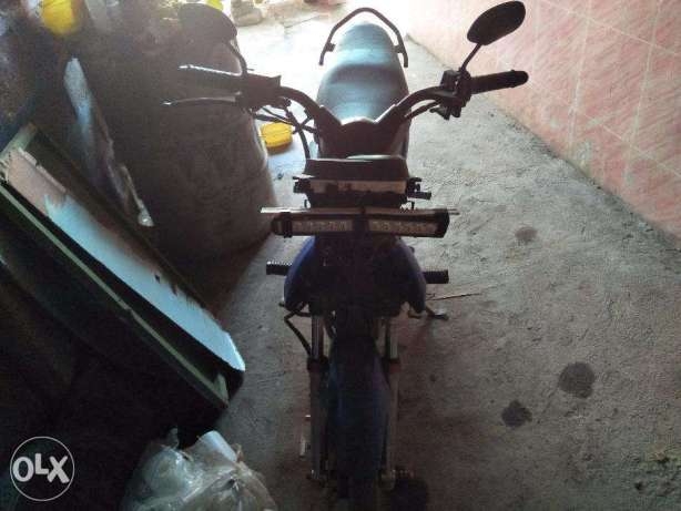

Here another solution in case you need a lot more light and not just a little bit more:

You can see my extra light on my wave
together with the LED headlight bulb the light is amazing !
