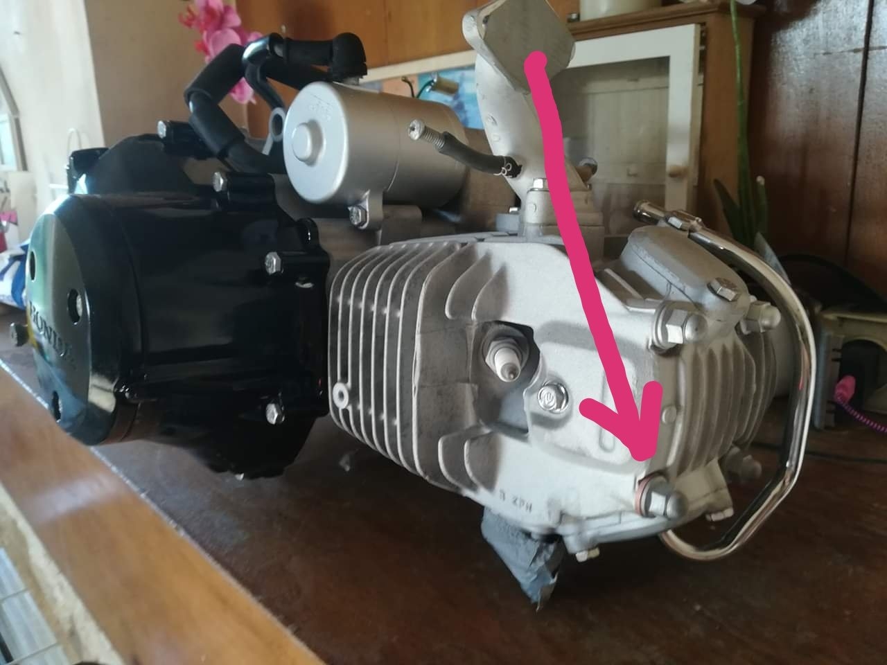

Hi, does someone have a oil cooler on his innova? I tried to fit one today but it seems like the oil coming verry slow out of the oil cable.. So thats not good..
I see on greek forums that they fit it on the head bolt from the cylinderhead..(like the honda grom) So i did it on the same way..
Is there a other way or do i need a stronger oil pump? 🤔

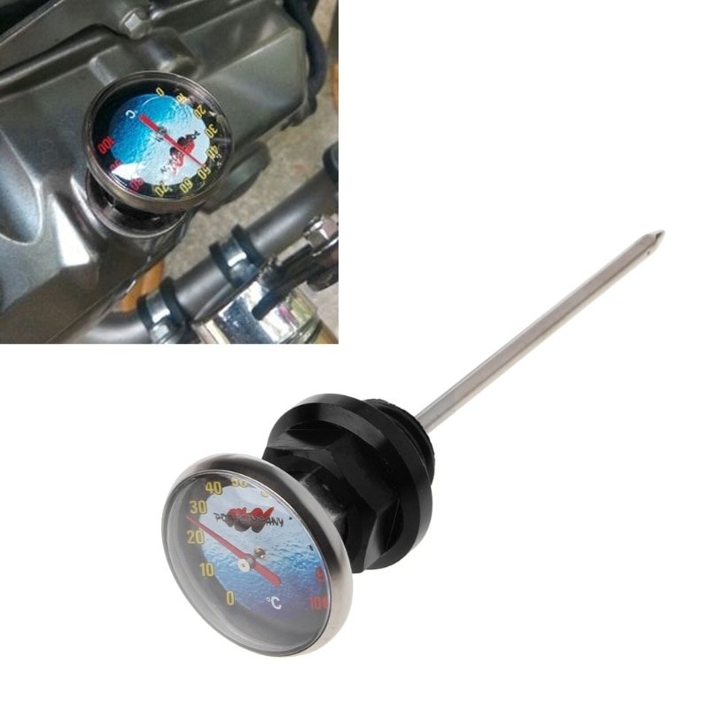

I have ordered a oil temp sensor so i dont now how warm he get exactly.. But he gets warmer than original. Engine has about double hp so i think i need it for sure

measure the oil temperature first. Usually CUBs are running rather cold and for example my Suzuki GS500e was also without an oil cooler and temperatures of 140°C where easily possible and the engine was totally fine with that. You just need the correct oil. I'd rather simply switch to 20W50 instead spending hours for mounting an oil cooler
